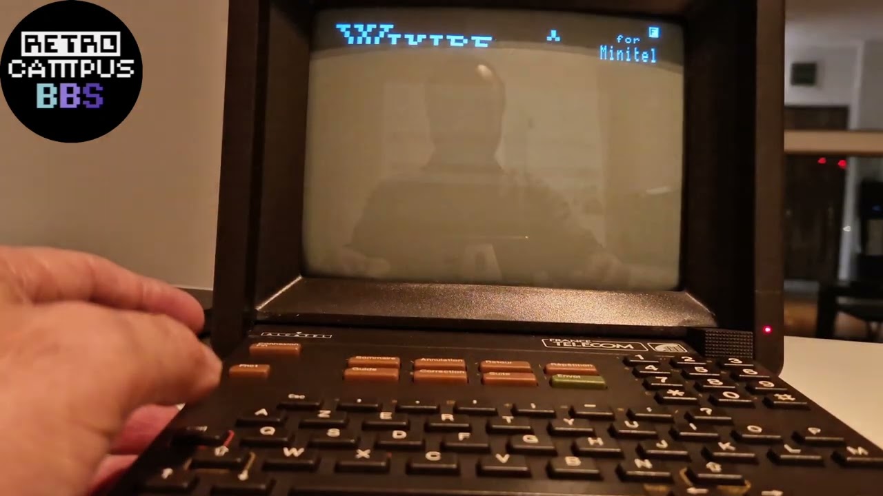

May I ask you something? To connect with your dial-up and select « Z » from main menu, then post a photo?
Like this https://www.youtube.com/shorts/ZM5TdxFAprI
I got this :
It showed up very briefly then went back to the main menu.
If there are no DRCS… use blocky chars! Here is the splash screen
